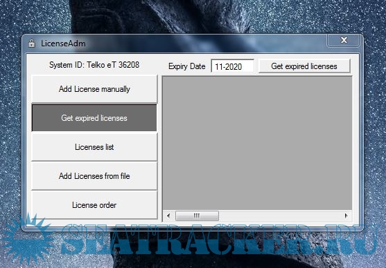

hello friend i have Problem When Open Telechart have some error CMap init error when i am ok g_manager ->Init() failed could you solve my problem how many time iam uninstall and then install again some problem
SailorF54   17-Jan-2021 17:14
yep.zenith,
Possibly because you have not set up the charts (CM93 V3) correctly (with GDBAdmin.exe and LicenseAdmin.exe in CM93v3 folder, they can also be called at the end of the installation process: strictly follow the steps in the installation guides !)
yep.zenith   19-Jan-2021 10:21
SailorF54, thanks working now i just go to system GDBAdmin.exe and LicenseAdmin.exe and i tried to unregistered and reregister again to gdbadmin and make licenseadmin now working as normal
