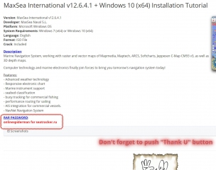

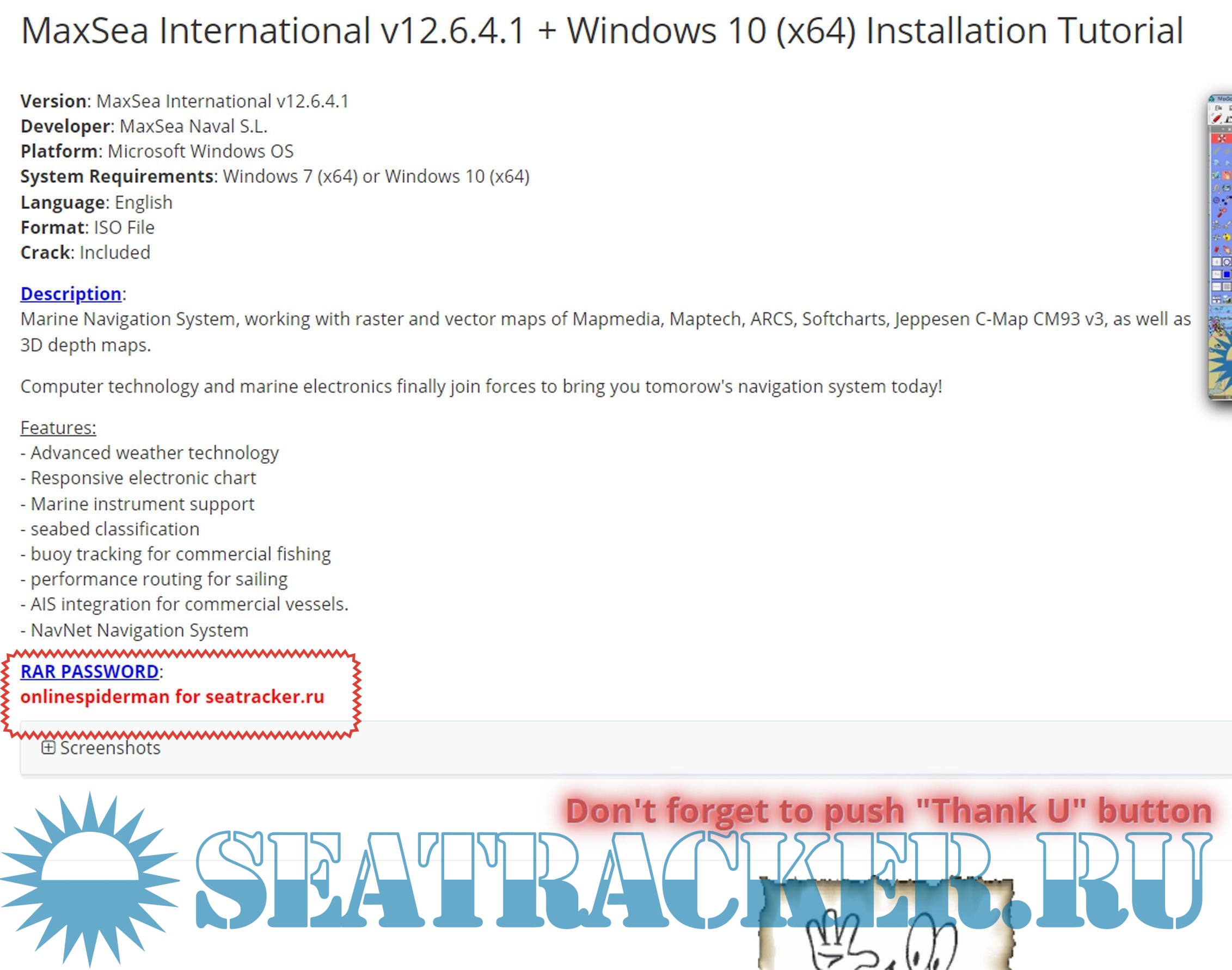

I downloaded maxsea and when extracting it from the rar file I am told that the password is incorrect. Would it be possible to have it please?
